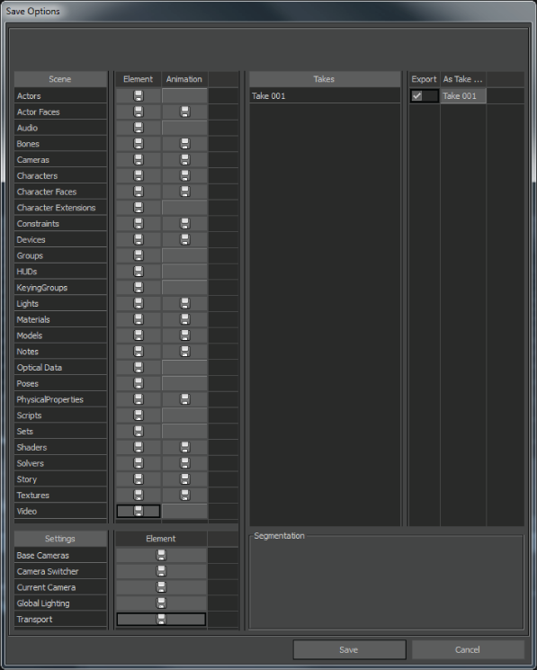

The Save Options dialog appears.
See Save Options window.
