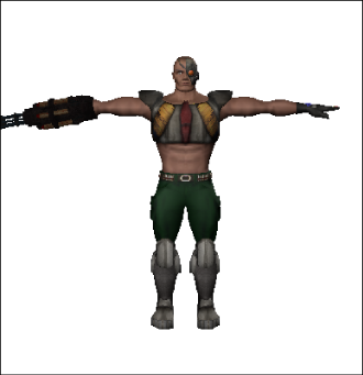

Biped character model
A stance for a biped model resembles a T pose in which the arms are parallel to the floor, the feet are flat on the floor, and the spine is straight. The model should face towards positive Z-axis. This is referred to as a T-stance. See Stance.
If your biped model uses fingers and toes, make sure each hand is open and flat with the fingers and thumb straight. For feet, the ankle should be bent to ensure proper floor contact and the toes should be straight and pointed toward the positive Z-axis.
