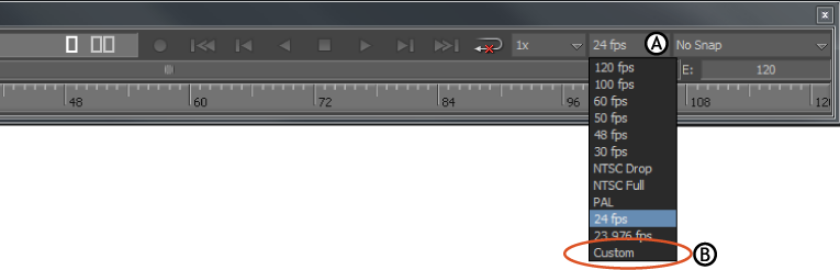

To select a custom frame rate:
  1. Click the Time Format field in the Transport Controls, then select Custom from the menu.
    Transport Controls A. Time Format field B. Custom option
    The Custom Frame Rate dialog box appears.

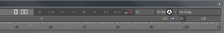

    The custom frame rate is selected in the Time Format field.
    Transport Controls A. A custom frame rate is selected.
    When you save your scene, the selected frame rate is also saved.
