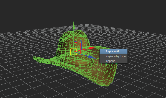

Apply various types of shaders directly to models to obtain different effects.

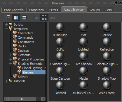

To apply a shader to a model:
Thumbnail view of the shaders in the Asset browser
Viewer window A. Shader context menu
| Context menu option | Description |
| Replace All | Replace All replaces all shaders applied to the object with the selected shader. |
| Replace by Type | Replace by Type replaces all shaders of a certain type with the selected shader. |
| Append | Append adds the selected shader to shaders already applied to the object. |
