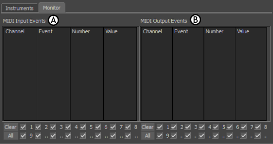

The Monitor pane shows MIDI data as it is received and sent. Two separate tables show the MIDI data being received (MIDI Input Events) and sent (MIDI Output Events). Each table contains similar columns.
Monitor pane A. MIDI Input filtering options B. MIDI Output filtering options
Displays the channel number of the received or sent event.
Displays the event type. An event type can be either Note On or Control:
The value shown in the Number column changes depending on whether the event is a controller or a note. If the event is a controller, the Number column shows the controller number. If the event is a note, the Number column shows the note number. Each note is assigned a number between 0 and 127. For example, C4 (C octave 4) displays as 60.
The value shown in the Value column changes depending on whether the event is a controller or a note. If the event is a controller, the Value column displays the controller value. If the event is a note, the Value column displays the note’s velocity.
