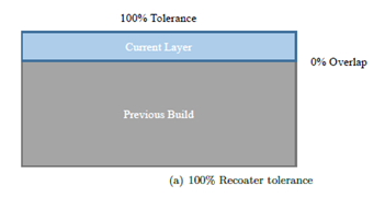

In Figure a, 0.040 mm is allocated for the fusion of the next layer, and there is 0.040 mm on top of the build, which results in a 100% tolerance or clearance.

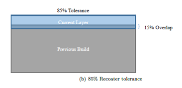

In Figure b, upward distortion of the previous build has taken up 0.006 mm or 15% of the tolerance, which results in 85% of tolerance remaining. This would be acceptable if your recoater tolerance was set to the default value of 20%.

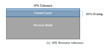

In Figure c, there is a 0.0321 mm build overlap, taking up 81% of the tolerance. As a result, only 19% recoater tolerance remains and the system issues a warning message, as the tolerance is below the threshold of 20%.

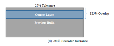

In Figure d, the build of 0.050 mm exceeds the entire recoater clearance of 0.040 mm for the current layer, so it returns a warning and a calculated interference of -25%. This loss of tolerance would almost certainly result in recoater blade damage.
