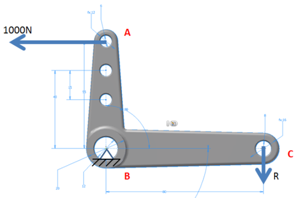

The model is a lever arm as shown:
- A 1000 N load is applied to the top-most hole (A).
- The lever is pinned at the center (B).
- We assume a rod passes through hole (C) and is locked against movement.
- The reaction force, R, balances the loads, so the part is in static equilibrium. A force summation results in R = 687.5 N.

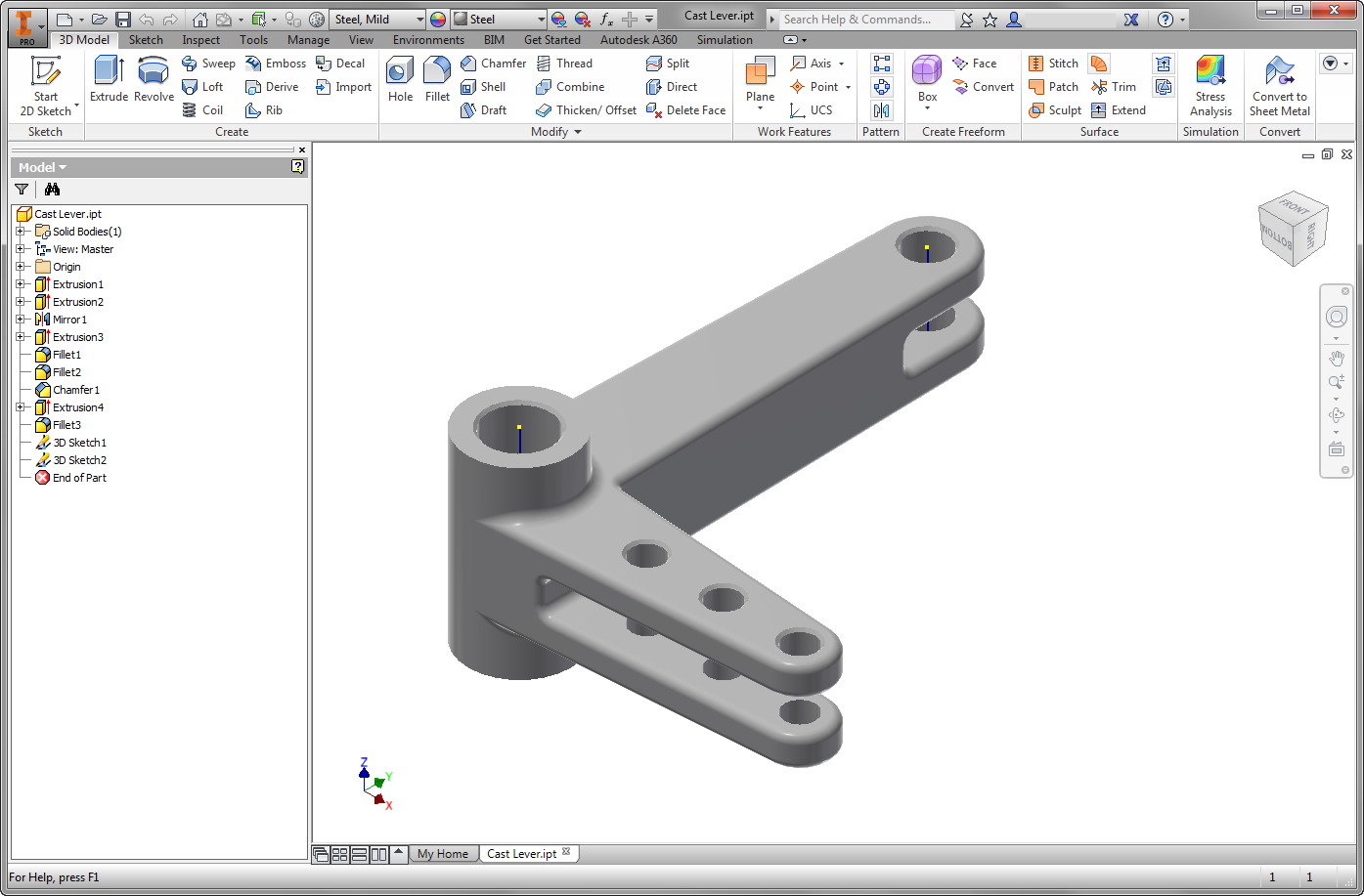

1. Open the Model and Start the Autodesk Nastran In-CAD Environment
 Start Autodesk® Inventor, and open Cast Lever.ipt from the Section 5 - Cast Lever sub-folder of your training exercises folder. (Get Started > Launch > Open).
You should see this:

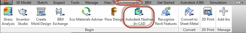

From the ribbon, click the Environments tab, and click Autodesk Nastran In-CAD:

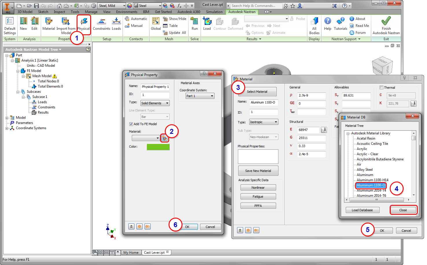

2. Define the Physical Property
- Click Physical from the ribbon.
- On the Physical Property dialog, click the New Material icon.
- On the Material dialog, click Select Material.
- On the Material DB dialog, expand the Autodesk Material Library list, and select Aluminum 1100-O from the list. Click Close.
- Click OK on the Material dialog.
- Click OK on the Physical Property dialog.

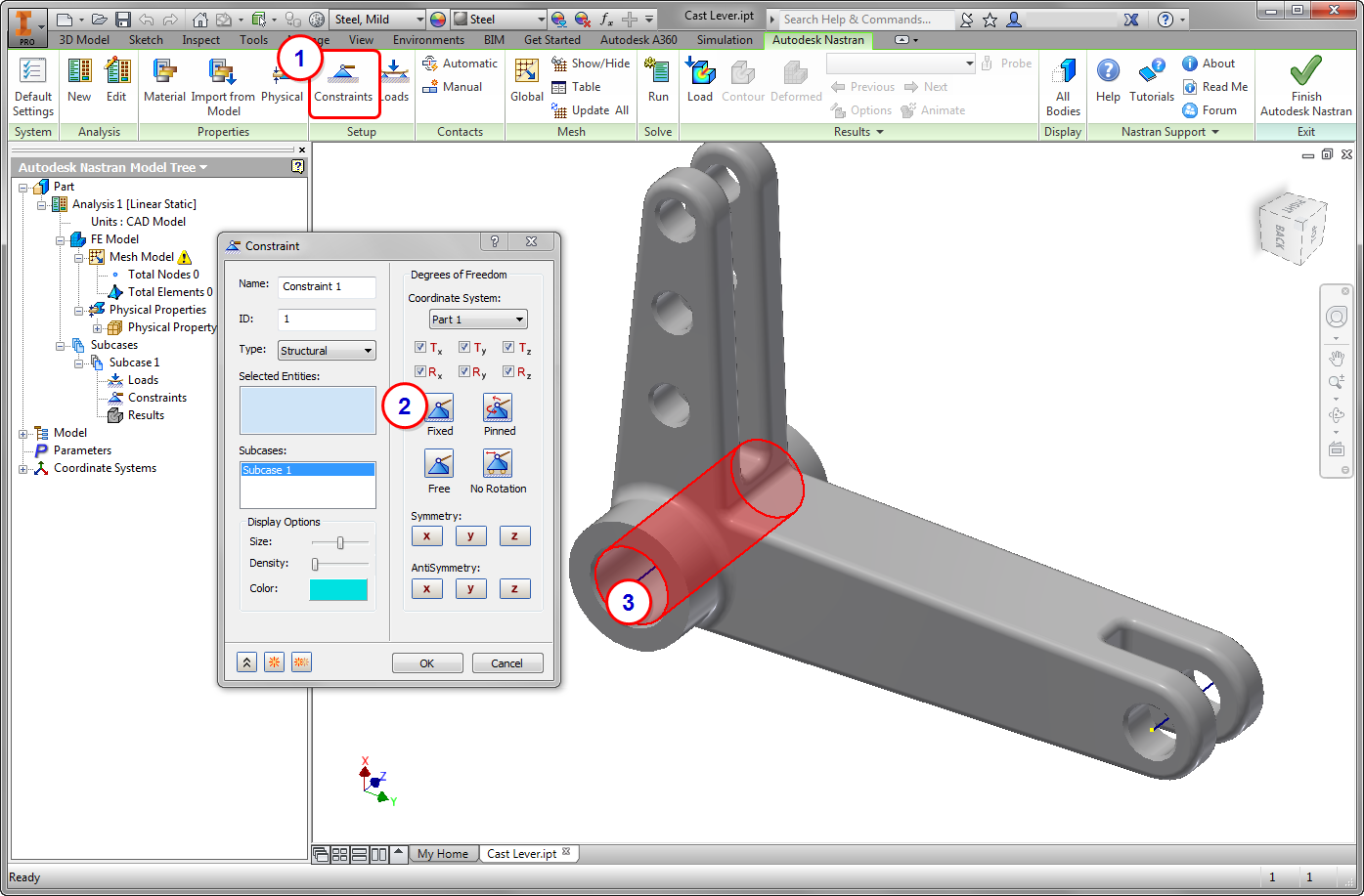

3. Constrain the Lever
- Click Constraints from the ribbon.
- Make sure the Fixed constraint is specified. (It is the default setting.)
- Select the inside surface of the center hole (as shown), and click OK.
Note: Because the loads are balanced, we don't expect any rotation about this axis. This is why we have applied a fixed constraint at this location.

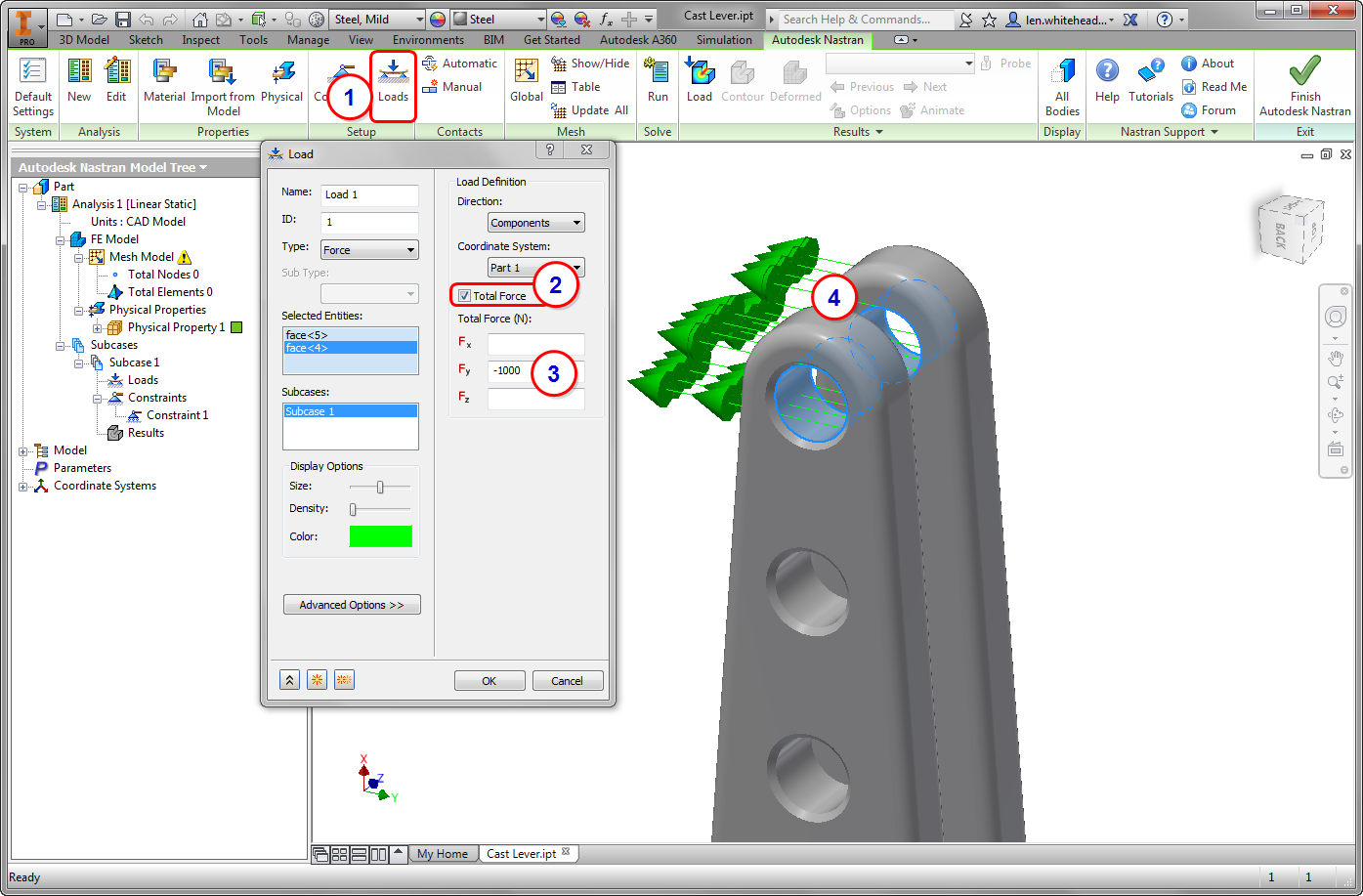

4. Define the First Load
- Click Loads from the ribbon.
- On the Load dialog, check the Total Force box.
- Enter a load of -1000 for Fy.
- Select the inside surfaces of the two holes as shown, and click OK.

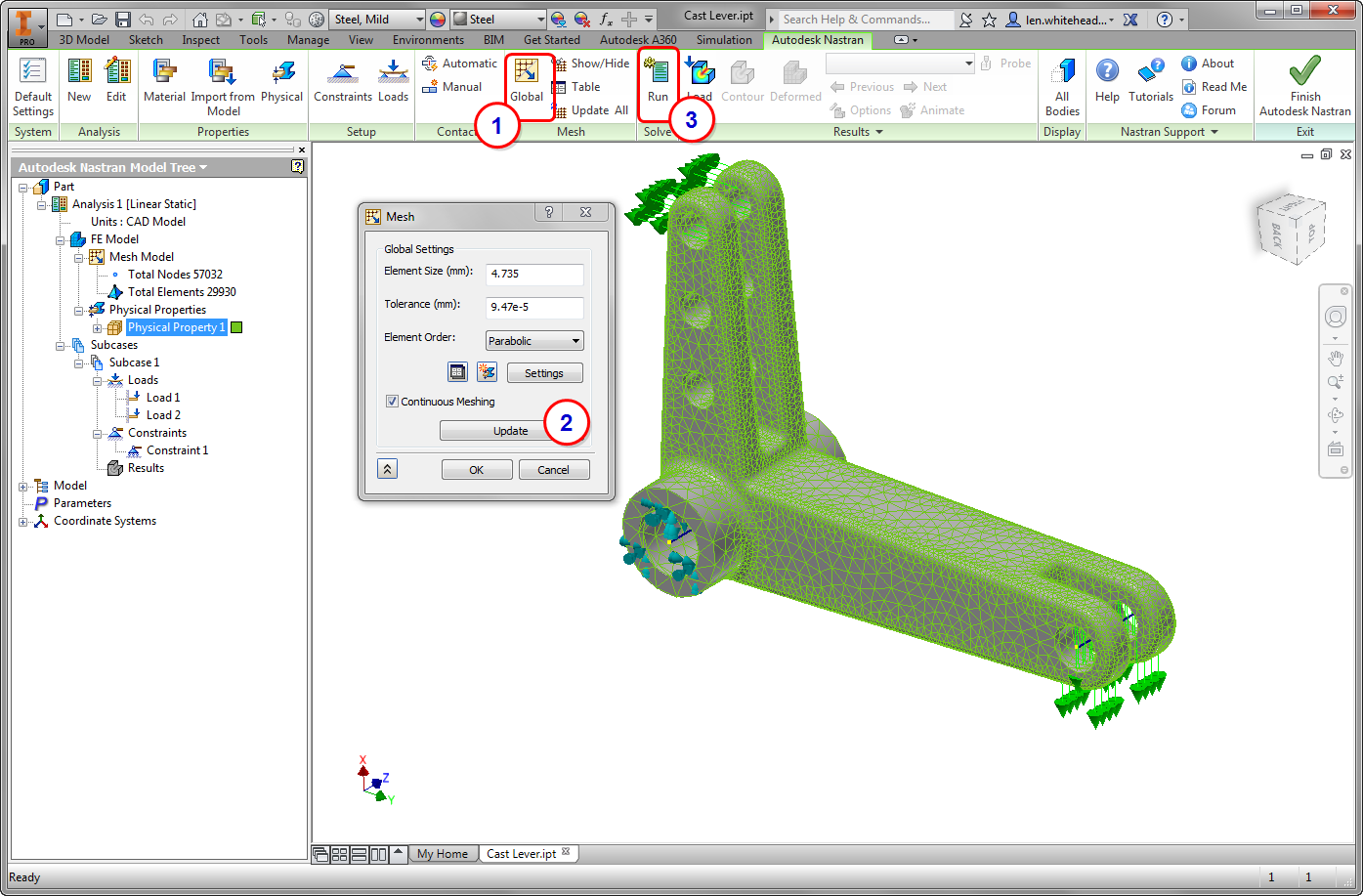

6. Mesh the Part and Run the Analysis
- Click Global from the ribbon.
- On the Mesh dialog, click Update.
- After the mesh generates, click Run to start the analysis.
Note: While the simulation runs, the Model Tree changes to show the Autodesk Nastran Output. You may see red messages in the output. These indicate that Autodesk Nastran identified elements that are poorly shaped. We will ignore these warnings for this exercise.
When the run is complete, click OK on the message box that indicates that the solution is complete.

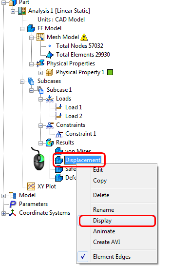

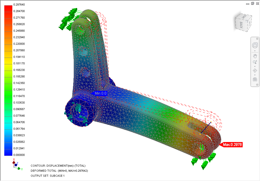

  To plot displacement, right-click on
Displacement from the tree, and click
Display:
 To animate the displacement, right-click on Displacement, and click Animate:
 To stop animation, right-click on Displacement, and click Animate so that it is unchecked.

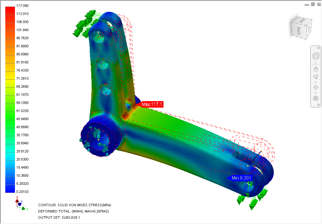

 To plot von Mises stress, right-click on von Mises, and click Display:
 To disable the element edges, right-click on von Mises, and uncheck Element Edges:

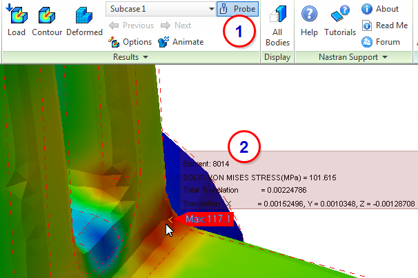

8. Probe for a Specific Value
-  Click the Probe command from the ribbon.
- Hover over the a location on the lever arm. The results are displayed:
