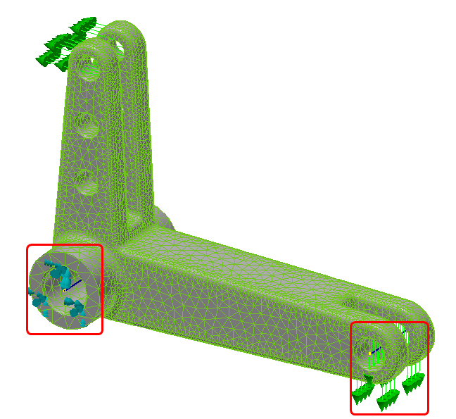

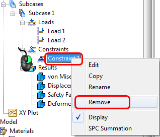

We need to remove the constraint and the load at the end of the lever:
To remove the constraint, right-click on the constraint in the Tree, and select Remove:
To remove the load, right-click on the load in the Tree, and select Remove. Be sure the select the correct load by ensuring that the desired condition highlights in the model, as shown above:

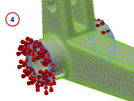

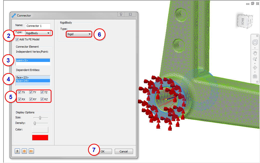

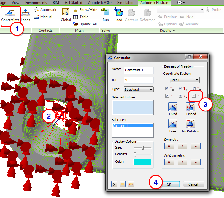

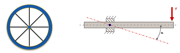

A commonly used technique in FEA is the 'ball joint' constraint to control rotations. The ball joint constraint uses rigid elements to control a reference point. The rigid elements are often called 'spokes' or 'spider webs', given their appearance. We tie the movement of an edge or surface to a reference point to allow for more natural movement. In Autodesk® Nastran® In-CAD, this is done with a Rigid Connector:

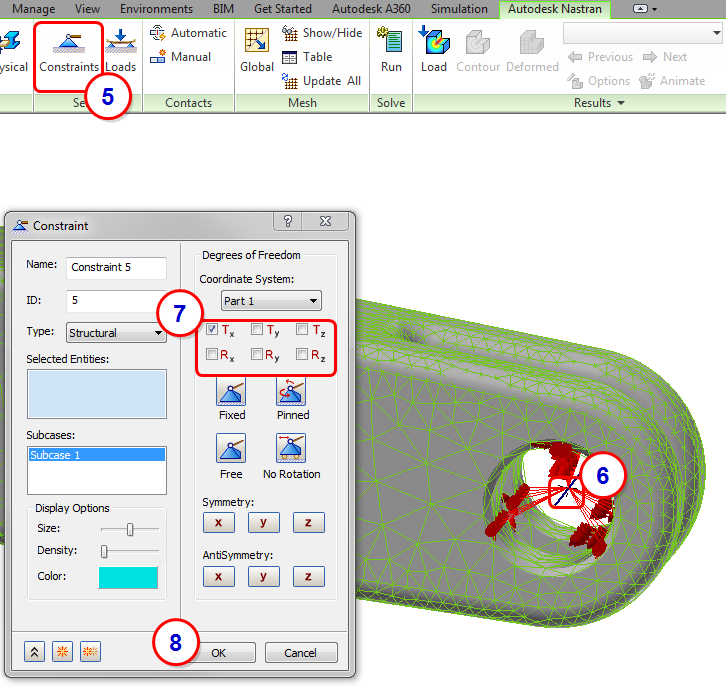

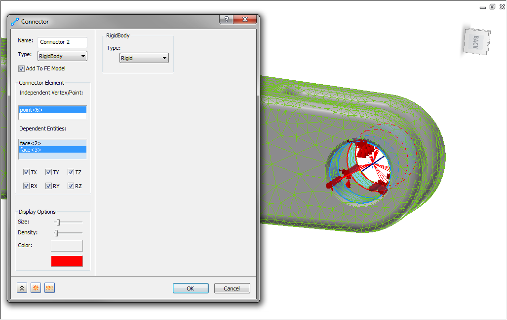

Repeat the procedure to create the ball joint constraint on the small hole. For the Independent Vertex, select the reference point on the axis. For the Dependent Entities, select the inner diameter surface from each hole, as shown:

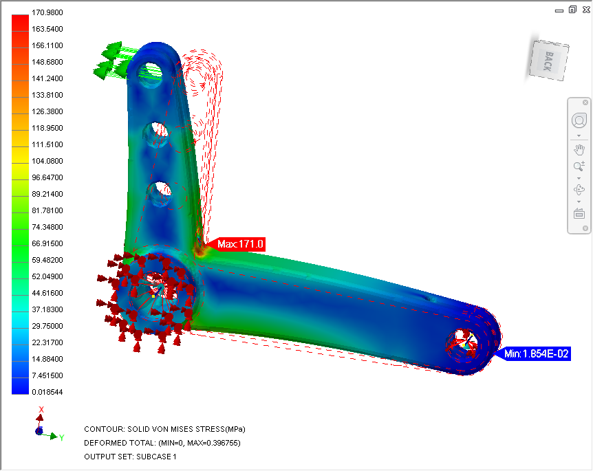

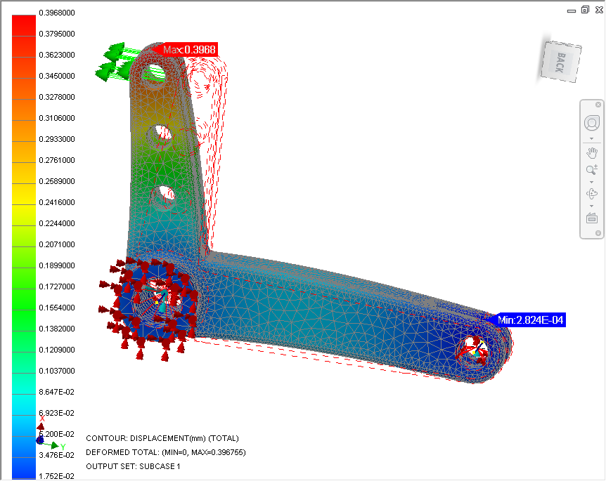

To plot von Mises stress, right-click on von Mises from the tree, and click Display. To hide the element edges, right-click on von Mises, and uncheck Element Edges:
We replaced clearly incorrect loads and constraints with advanced techniques that produced a much more realistic deformation.
Rigid Connectors have many uses beyond Ball Joint Constraints. Further research or discussion with an Autodesk Simulation expert can help identify which of these are important for your work.
Even with the improved boundary conditions, the controlling stress did not change appreciably. This should NOT be taken to mean that stress is insensitive to boundary conditions. It is, and this was simply a coincidence of this particular model.
