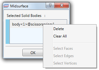

  1. Click Autodesk Nastran Prepare Find Thin Bodies to analyze the CAD geometry and automatically detect thin bodies that might best be represented using shell elements. If any thin bodies are detected, a pop-up message asks if you would like to generate midsurfaces.
  2. Click OK to continue or Cancel to abort the operation. The Midsurface dialog appears, listing the detected thin bodies.
  3. You can right-click items to Delete them from the list, preventing their conversion to midsurfaces. Use the Clear All command to remove all solid bodies from the list. You can also graphically select bodies to convert to midsurfaces, adding them to the list.
  4. Click OK to continue or Cancel to abort the operation. The selected solid bodies are replaces by midplane surface representations (midsurfaces). New midsurfaces are listed in the Idealizations\Shells branch of the model tree.

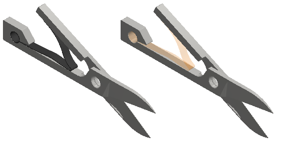

The following images compare a CAD model before and after using the Find Thin Bodies command. The solid spring on the left is replaced by the midsurface spring on the right:
