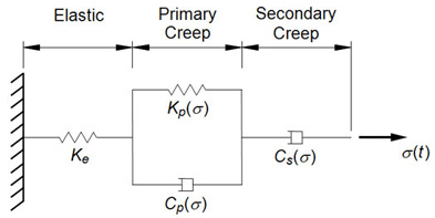

  5. Creep model parameters , , and represent parameters of the uniaxial rheological model as shown in the following figure.
    Tabular values (Xi, Yi) in the TABLES1 entry correspond to , , and for the input of , , and , respectively. For linear viscoelastic materials, parameters , , and are constant and two values of must be specified for the same value of , , and .
Figure 1. CREEP Parameter Idealization

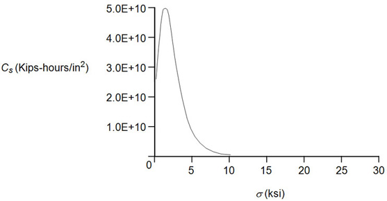

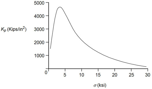

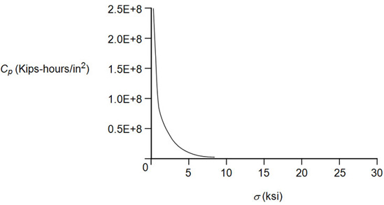

Creep model parameters, as shown in the figures below, must have positive values. If the table look-up results in a negative value, the value will be reset to zero and a warning message will be issued.
Figure 2. K p Versus σ Example for CREEP
Figure 3. C p Versus σ Example for CREEP
Figure 4. C s Versus σ Example for CREEP
