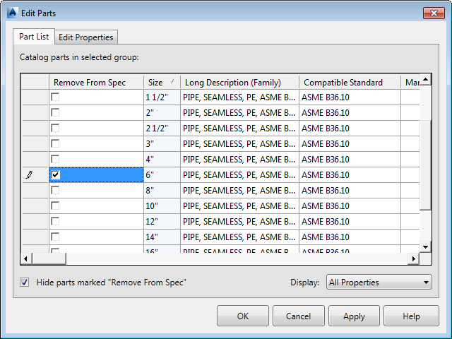

If the component size that you want to add does not appear when you clear Hide Parts Marked Do Not Include, you can use the catalog editor to add the size.
Toolbar: Edit PartsIf the field type is Yes/No (checkbox) enter a default value of True or False.

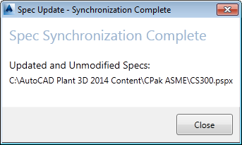

To synchronize specs with catalogs, the spec file must be closed and exclusive access to the spec file is required.
