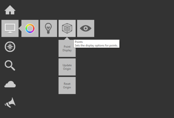

On the Project screen, hover over Display Settings → Points → Update Origin.

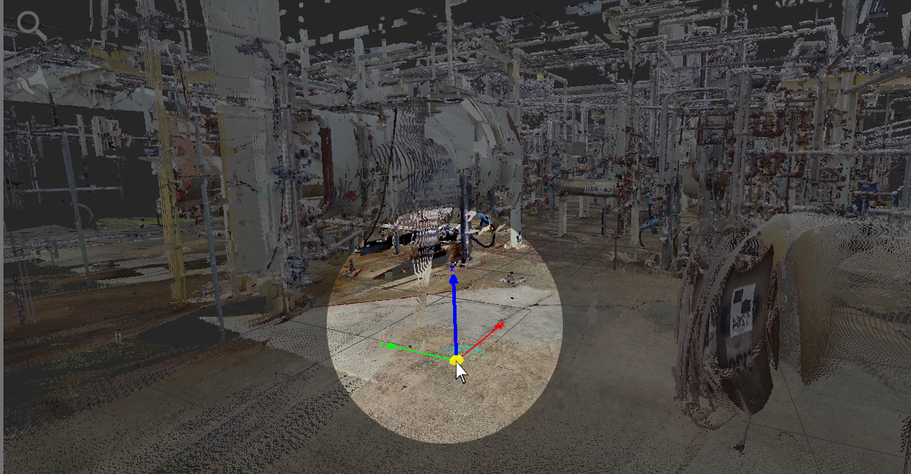

In the point cloud, click the new origin point and press the Tab key. A blue disk graphic indicates the plane that is perpendicular to the current z axis (which indicates the "up" direction).
