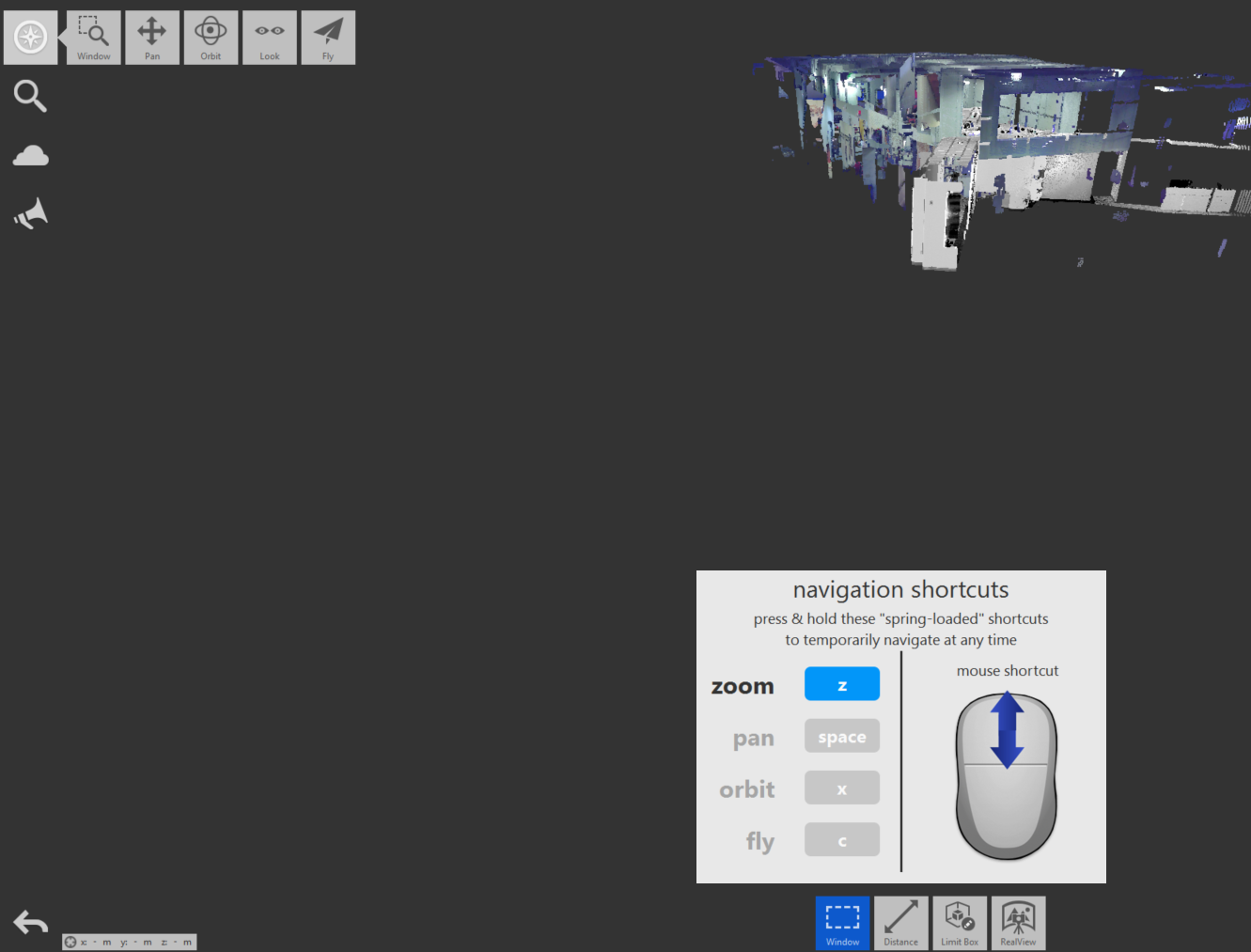

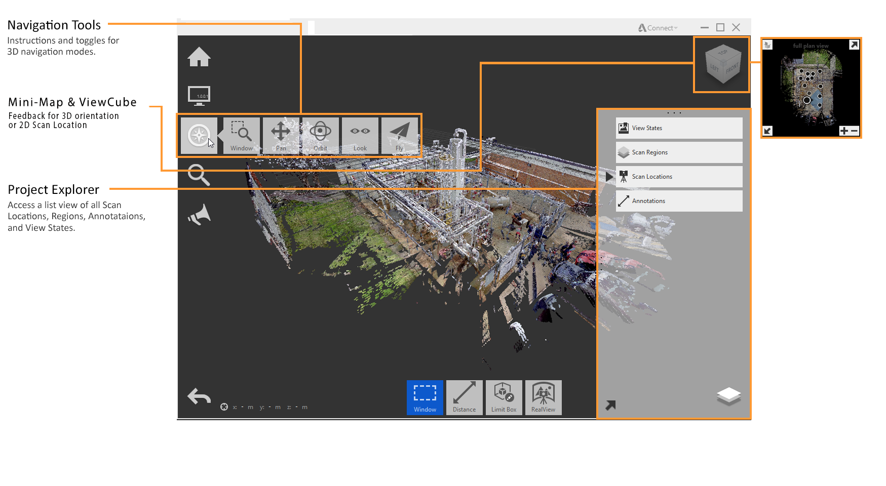

ReCap 360 allows for viewing in all tiers from both the desktop and web platforms. In addition to viewing point cloud data, the web provides access to Photo-to-3D viewing. There are two primary viewing "modes" within ReCap 360 for the exploration of point clouds: a full 3D mode with a RealVew option and a 2D panoramic view. On the web, this is limited to a 2D panoramic view for point cloud data with a full 3D environment provided for Photo-to-3D projects. Controls between the two states.
If you have experience with other 3D tools, many of these conventions should feel natural and share similar patterns.
In addition to simple navigation behaviors, ReCap 360 also provides a broad set of render options that allows you to configure the point cloud's visualization to your specific needs.
