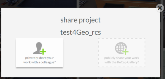

Share
ReCap 360 offers the ability for you to privately share your project via email with whoever you wish. You also define the permissions for the user to specify at which level they can manipulate the file. You can also opt to share your project publicly with the ReCap 360 community for feedback or to provide gallery examples of your photo or point cloud projects. For more information, see Publish and Share Data.

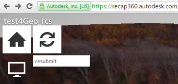

To resubmit your photo project, hover over the 3-dot menu and click "resubmit". Regardless of whether you have a ReCap 360 Pro subscription or have purchased or been appointed Cloud Credits, the same export options will appear to you as when you first submitted your project. You can also resubmit from the RealView screen from the Home flyout menu:
Rename
Projects can be renamed from within your A360 Drive through the Options menu, however the new name will not reflect in ReCap 360's web interface. In order to rename through ReCap 360's web dashboard, you will need to resubmit your project and specify a new name. This will simply copy your project with the new name. When clicking Resubmit brings you to the "add photos" page, bypass the page by clicking "settings". You will be able to specify a new project name at the Export page. Choose the same export option and adjust the title if you wish to simply rename your project. After this point, if desired, you can delete the obsolete project with the old name from the dashboard.

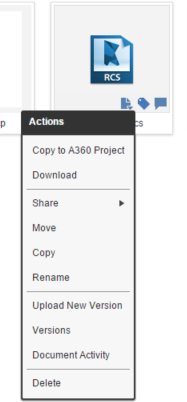

Downloading your file from either the ReCap 360 or the A360 Drive web interface is simple. Simply click the 3-dot menu (ReCap 360) or the Actions menu (A360 Drive) and click your intended task.
