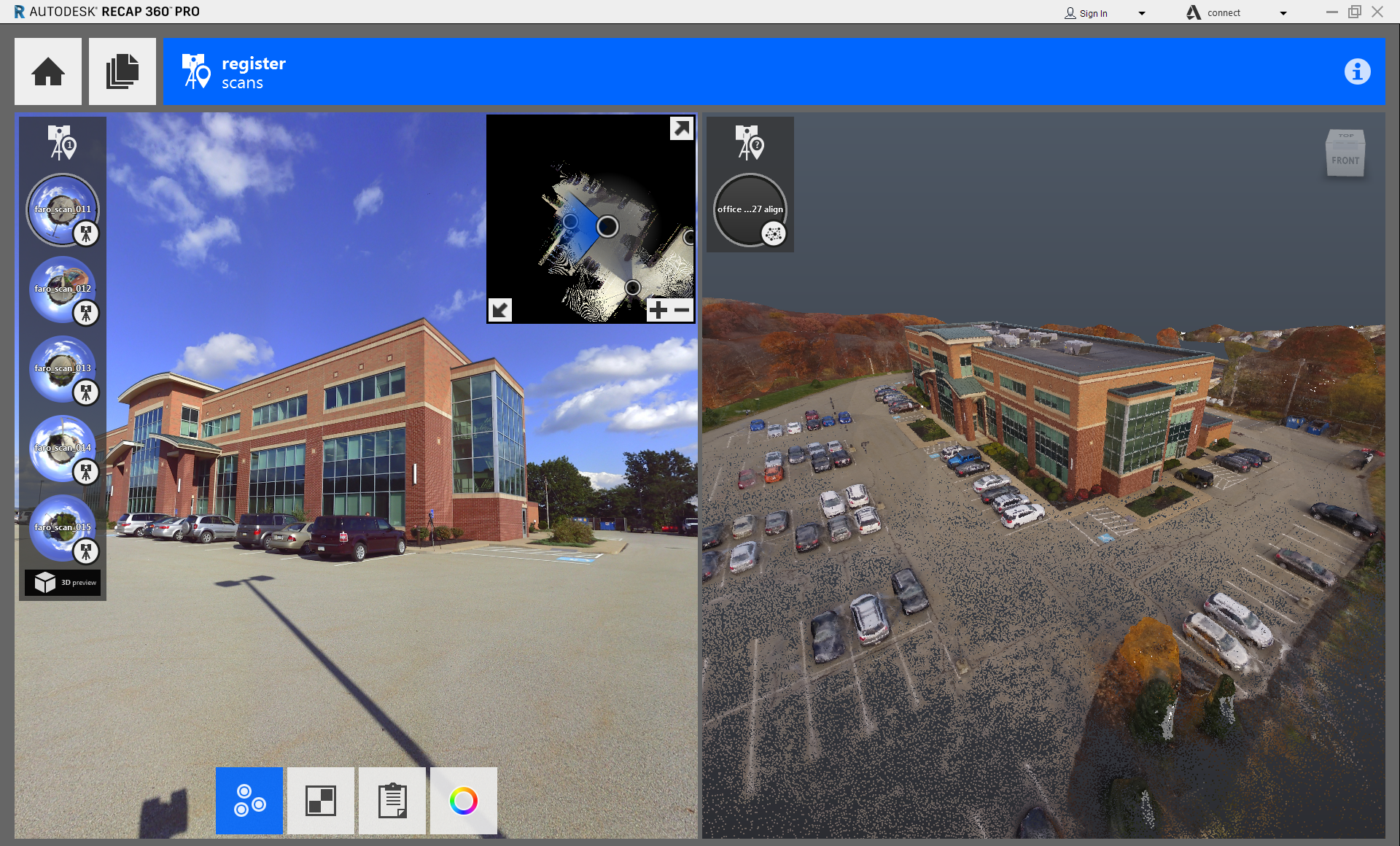

  2. Select an unstructured file for registration.
    The file opens in the right pane of your screen, and your view switches to a full 3D environment.
  3. Follow standard Manual Registration procedure, selecting the same point features in each image.

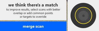

    You must enter at least three matched points between the two scans. For best results, ensure that the points are selected precisely. When ReCap has enough data to register the new scan, you see this dialog:
  4. To complete the registration, click Merge Scan.
