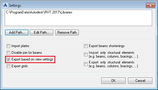

Export Based on View Settings
The Export based on View Settings option increases usability by allowing you to export objects, using the Revit view settings:

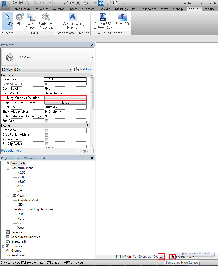

This option considers the settings made in:
If the option is selected and you isolate elements inside the model using the previously mentioned menus, only the elements displayed in the canvas will be exported.
