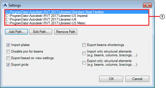

Specify options to import and export elements between Advance Steel and Revit.
You can access the
Settings dialog in the
Add-Ins tab >
Advance Steel Extension panel in the ribbon and find the following options:
- Path configuration for Revit library - Steel section definitions
Import plates - Allows the import of Plate objects in Revit.
Disable join for beams - Disables the automatic Revit joint for steel beams during import .
- Export based on view settings -
Allows the export of objects, using the Revit view settings.
- Export grids -
Allows the transfer of grid elements.
Export beam shortenings - Exports shortenings to Advance Steel for beams joined automatically by Revit.
Import only structural elements and
Export only structural elements - Turns the
import/export of only structural elements (beams, columns etc.) on or off.
