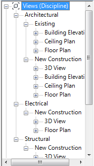

You can sort views and sheets in the Project Browser using any of the property values for the view or sheet.
For example, the following image shows views in the Project Browser organized by discipline, then by phase, and then by view type. The top level of the Views branch also shows the name of the sort group currently applied (in this case, Discipline).
