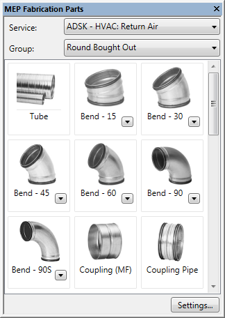

To place parts, select a service and a group.
Use the MEP Fabrication Parts palette to select a service and a group, and select fabrication parts to place in the drawing area. If no parts are listed in the palette, click Settings to open the Fabrication Settings dialog and load content into the MEP Fabrication Parts palette.
Video: Creating an MEP Fabrication Model in Revit
  1. Display the MEP Fabrication Parts palette.
    The palette displays by default when you create a new model in Revit. If the palette does not display, click Systems tabFabrication panel (Fabrication Part). Alternatively, click View tabWindows panel User Interface drop-downMEP Fabrication Parts.
    Note: If prompted to specify a fabrication configuration, use the Fabrications Settings dialog to specify a fabrication configuration and load services.
  2. In the MEP Fabrication Parts palette, select a Service and a Group from the drop-down lists.
  3. Click a part button.

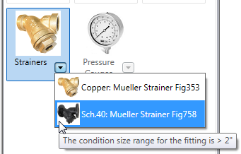

    • Some part buttons have an arrow that allows you to select from a list of available parts. A tooltip for each part displays the condition for which the part will be used.
      When you click the arrow, a drop-down list displays additional parts based on the size. This drop-down list is controlled by the conditions in the service definition, similar to routing preferences. For example, a bend may use a pressed bend up to a certain size, and a segmented bend above that size. When you place the cursor over a part in the list, a tooltip displays the size range based on the condition for that part.
