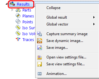

The right click menu provides a set of controls that apply to the entire model:
If a setting is changed after a scenario is run, the warning icon appears on the Results branch:
This means that the results do not match the settings in the scenario. To resolve the inconsistency, run the scenario again with the new settings.

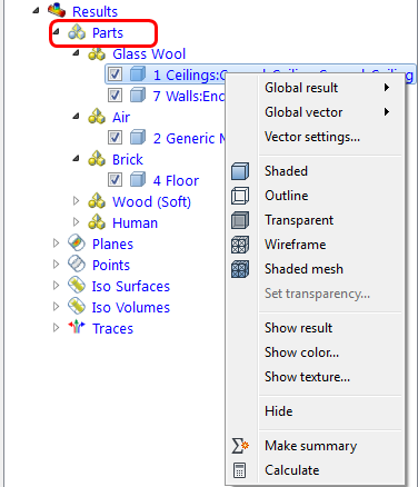

Parts are organized by their assigned materials in the Parts branch. This is a convenient way to control the appearance and visibility of parts while reviewing results.
To hide a part, uncheck the box adjacent to the part ID.
These commands provide the ability to change the displayed result on a part, change part appearance, assign parts as Summary Parts, and to calculate part-based results such as temperature using the Parts tool.

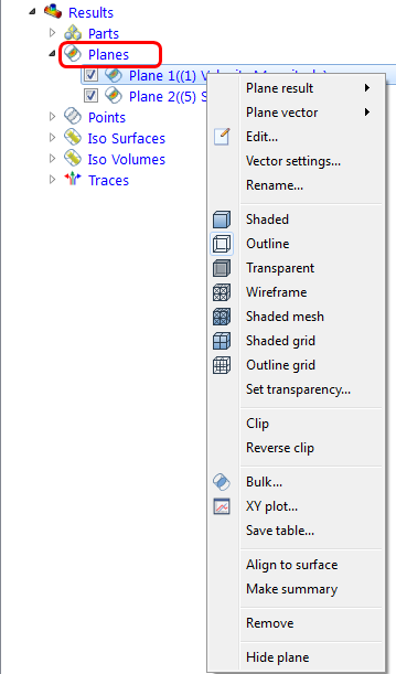

From the Planes branch, you can create new results planes by right clicking on the branch, and clicking Add plane.
Every plane is listed as a sub-branch. To hide a plane, uncheck the box adjacent to the plane ID.
The right-click menu provides a comprehensive set of controls for Planes:

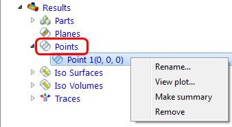

From the Points branch, you can create new Results Points for monitoring time and iteration history of results at specific locations in the model.
The right-click menu provides a comprehensive set of controls for Results Points:

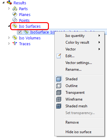

From the Iso Surfaces branch, you can create new Iso Surfaces by right clicking on the branch, and clicking Add iso surface.
Every Iso Surface is listed as a sub-branch. To hide an Iso Surface, uncheck the box adjacent to the Iso Surface ID.
		The right-click menu provides a comprehensive set of controls for Iso Surfaces:

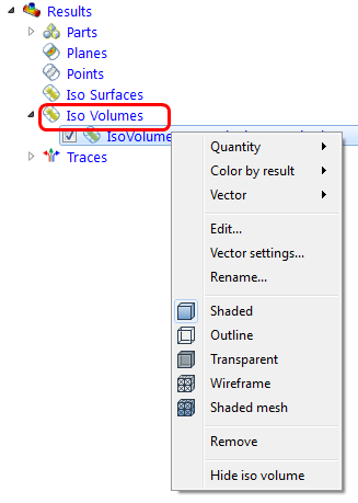

From the Iso Volumes branch, you can create new Iso Volumes by right clicking on the branch, and clicking Add iso volume.
Every Iso Volume is listed as a sub-branch. To hide an Iso Volume, uncheck the box adjacent to the Iso Volume ID.
		The right-click menu provides a comprehensive set of controls for Iso Volumes:

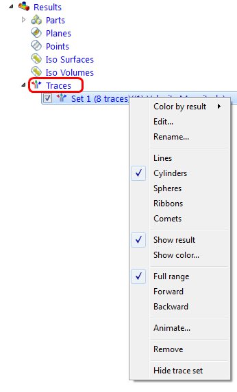

From the Traces branch, you can save trace data to an external file. To create new traces, use the Add command on the Traces context ribbon menu.
Every trace set is listed as a sub-branch. To hide a trace set, uncheck the box adjacent to the trace set ID.
		The right-click menu provides a comprehensive set of controls for particle traces:
