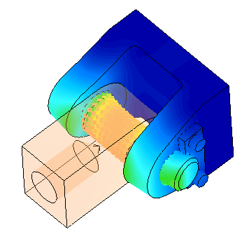

In this step, we animate the displacement of the pin.

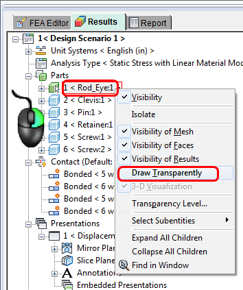

- To show the rod eye transparently, right-click on its entry in the Results tab of the Browser, and click
Draw Transparently.

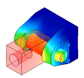

You should see this…

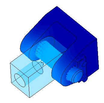

- To animate the displacement, click
Play from the
Captures panel.
