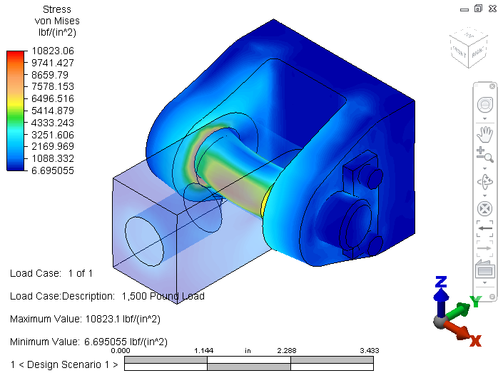

In this step, we examine the von Mises Stress values. We use a slice plane to provide a clearer view of the assembly parts.
- Click
von Mises from the Stress panel to display stress on the assembly.
You should see this…

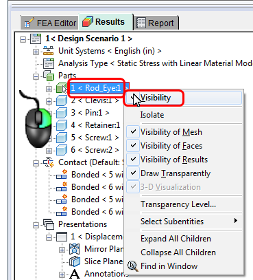

- To hide the rod eye, right-click on its entry in the Browser, and uncheck
Visibility.

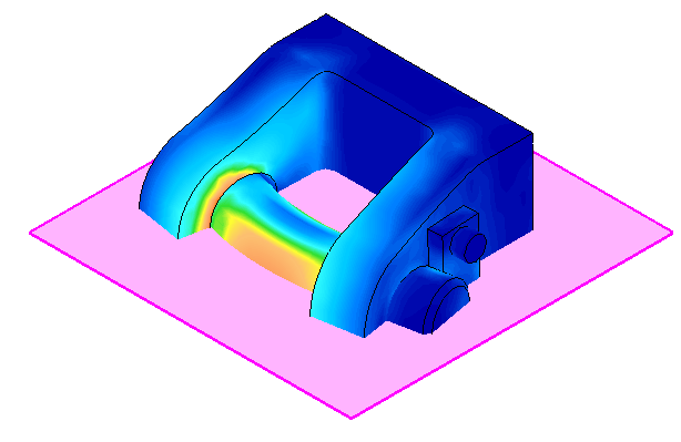

- To create a slice plane, click
Results Options
Slice Planes
Add Slice Plane
XY Plane.

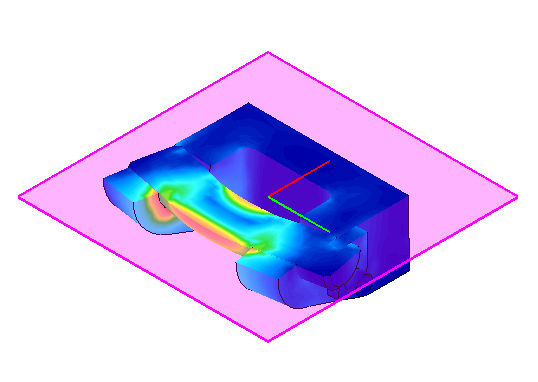

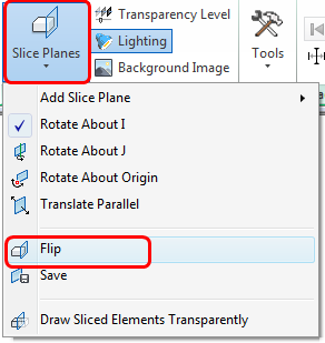

- To change the orientation of the plane, click
Slice Planes
Flip.

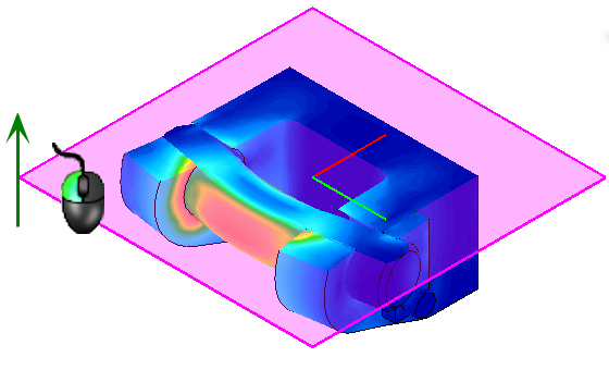

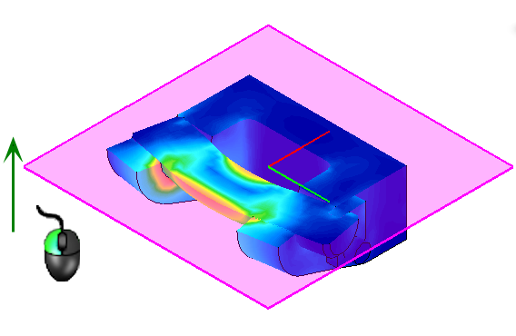

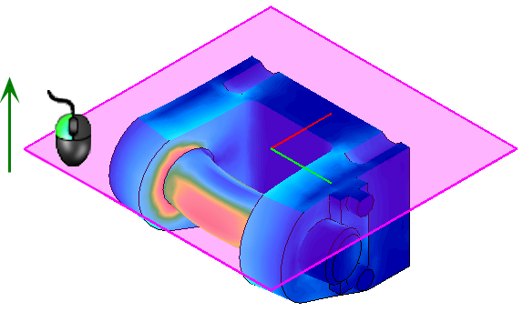

- To drag the slice plane through the assembly, click
Slice Planes
Translate Parallel.
- Click and hold the left mouse button on the slice plane, and drag it through the model. You should see this…

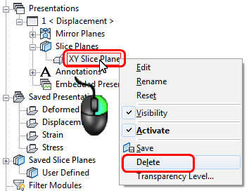

- To delete the slice plane, expand the
Presentations branch and the
Slice Planes sub-branch. Right-click on
XY Slice Plane, and click
Delete.
