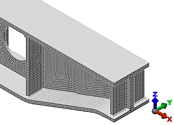

  1. Click Mesh Mesh 3D Mesh Settings.
    1. Click Options.
      1. Select Absolute mesh size from the Type drop-down list.
      2. Type 8 in the Size input field. This size results in three elements through the thickness of the top and bottom flanges, two through the gussets, and an overall high-quality surface mesh appearance.
      3. Click OK.
    2. Click Generate Mesh. The meshing process starts.
  2. When asked to review the mesh results, click No. The meshed model displays as shown in the following image. Due to the fineness of the mesh, the viewpoint has been zoomed-in to show only about one-third of the model, making the mesh lines more visible.
