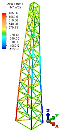

Now, we view the axial stress results.
  1. Select Results Contours Stress Beam and Truss Axial Stress. The model displays the in-phase results of the first frequency, where the axial stress varies between approximately +/- 1,351 psi.
    Note: The axial and worst stress values are equal, since trusses only support axial loads. That is, there are no bending stress components.
  2. Use the Results Contours Load Case Options Next command to view the remaining six load cases.
