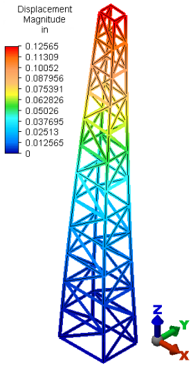

Click  Analysis Analysis Run Simulation. The analysis proceeds and the model appears in the Results environment.   By default, the displacement magnitude is presented initially.
The model displays the in-phase results of the first frequency.  The maximum displacement magnitude is about 0.126 inches, as shown below.
