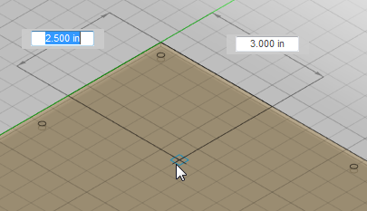

    3. Drag the mouse towards the opposite corner of the board to start a rectangle. One of the two dimensions is highlighted and the model appears2 as shown below. Since the chip is square (2 inch x 2 inch), the order that the two dimensions are specified does not matter.

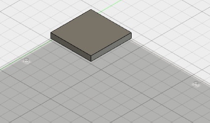

    5. Press Enter (or click OK) to complete the command and create the chip. The model should look like the following image:

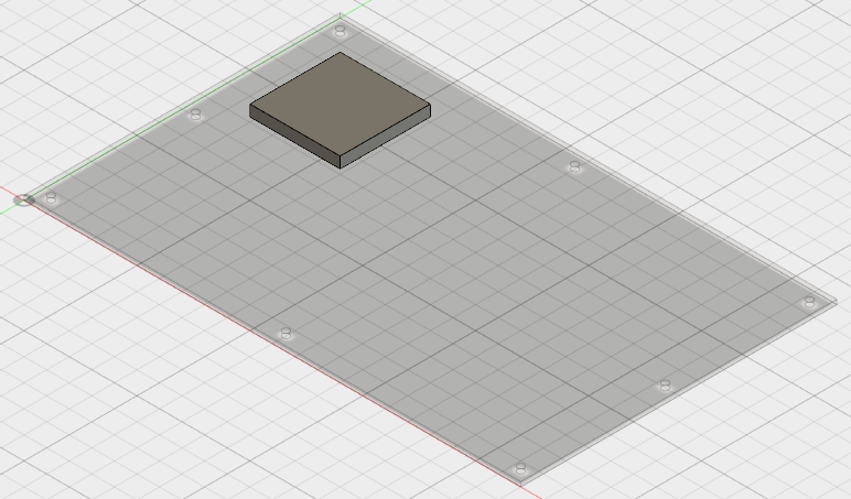

    3. Press Enter (or click OK) to complete the Move command. The model should look like the following image:
