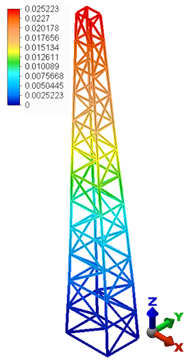

  1. Click  Analysis Analysis Run Simulation. The analysis proceeds and the model displays in the Results environment. By default, the displacement magnitude is presented initially.
  2. Select View Navigate Orientation Isometric View.
  3. The Results environment shows individual results for each of the 80 time steps.  Use the commands in the Results Options Load Case menu to select among the available time steps.
  4. To look at the displacement results from the last time step, Click Results Contours Load Case Options Last Results. The maximum displacement magnitude is approximately 0.025 inches, as shown below.
