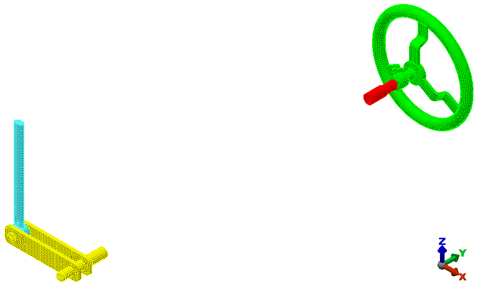

Solid Mesh the Model
  1. Select   Mesh Mesh  3D Mesh Settings.
    1. Click on the Options button.
      1. Select Absolute mesh size from the Type pull-down menu.
      2. Enter 0.1 in the Size field.
      3. Click OK to accept the mesh options.
    2. Click the Generate Mesh button.
  2. When asked to review the mesh results, click No. The model should look like the following image.
Note: Even though the default mesh type is Solid, only the surface mesh has been created at this point. By default, the generation of the interior mesh lines is postponed until the first time the Run Simulation or Check Model command is executed.
