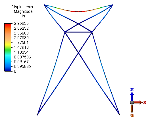

Analyze the Model
  1. Click Analysis Analysis Run Simulation.
    The analysis proceeds and the model displays in the Results environment. By default, the displacement magnitude is presented initially.
  2. If the load and constraint symbols are visible, click Results Options View Loads and Constraints to hide them. The model displays as shown below.
