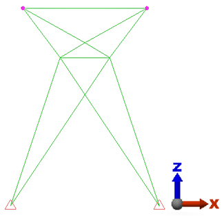

Next, we will apply the nodal forces to the top corner nodes.
  1. With the Selection Shape Point or Rectangle and Selection Select Vertices commands active, click the upper-left node of the model.
  2. Hold down the Ctrl key and click the upper-right node. Two vertices should now be selected, as shown below.
  3. Click Setup Loads Force.
    1. Type 5000 in the Magnitude field.
    2. Activate the Z radio button. Each node receives the specified force magnitude, so we have applied a total force of 10,000 lbf.
    3. Click the Flip Direction button ( ) to invert the sign of the Magnitude, reversing the direction of the load. We want the force to act in the -Z direction (downward).
    4. Click OK.
