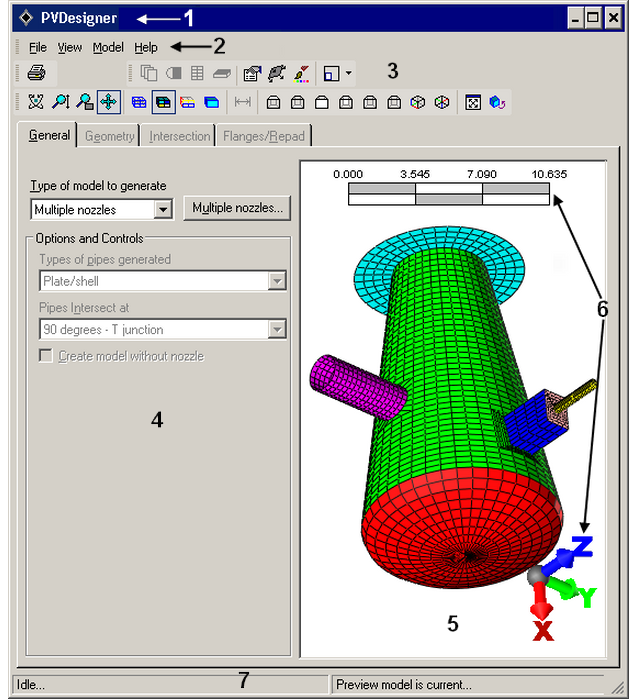

PVDesigner is a program in Autodesk Simulation that allows you to easily create intersecting cylinders or, more specifically, pressure vessels. This package will take the specifications (dimensions) you give it and will create a meshed model of either plate elements or bricks. Figure 1 shows the interface.
Figure 1: PVDesigner Interface
Toolbars command to choose which toolbars to display.
Preferences
MiniAxes/Dimension Scale command to control the visibility of these items. To access PVDesigner, click
New. Double click the PVDesigner icon. The PVDesigner dialog box will appear after you select a filename, analysis type and unit system.

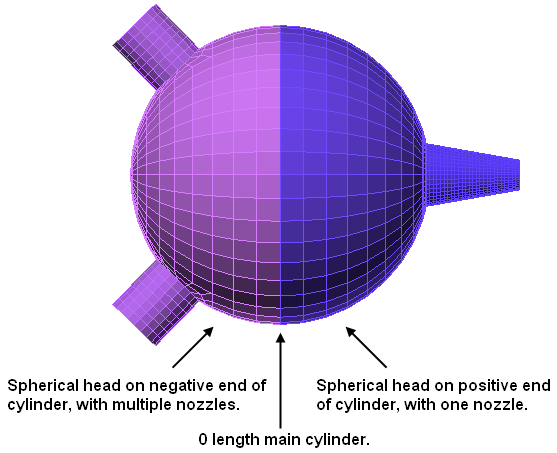

In many cases, complex vessels can be created with a single PVDesigner model by using a combination of the main cylinder, nozzles, heads, and nozzles on the heads. In other cases, multiple models can be created with PVDesigner and merged together in Autodesk Simulation. (Create each model separately, then use
Merge.) Examples are shown in Figures 2 and 3.
Figure 2: Spherical Vessel with Multiple Nozzles
