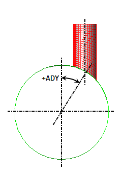

The Offset of nozzle specified using drop-down box on the Intersection tab is used to specify how to specify the offset out of the XZ plane. If the Distance option is selected, specify the location along the Y axis where the nozzle intersects the cylinder in the Nozzle's offset distance (DY) field. If the Angle option is selected in the Offset of nozzle specified using drop-down box, specify the angle at which the nozzle intersects the cylinder in the Angular offset of nozzle's axis (ADY) field. See Figure 1. Note that the nozzle is still parallel to the XZ plane. Note that this value follows the left-hand rule, so a negative angle rotates the nozzle about the +X axis.
| Offset of nozzle by distance | Offset of nozzle by angle |
| Figure 1: Offset of Nozzle | |
