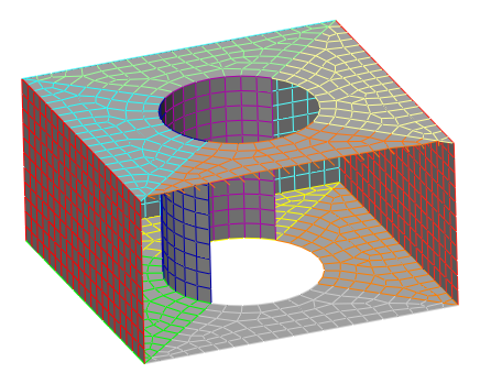

When generating a solid mesh on a part using Create Solid Mesh (or during the Verifying surface mesh stage of creating the surface mesh on a CAD solid model), the solid mesh engine first checks if the part is watertight. Watertight means that the mesh on all of the surfaces is complete, the lines of the mesh create valid elements, and the mesh properly connects to adjacent surfaces around the perimeter so that the volume is fully enclosed. (If you imagine puncturing the part with a hypodermic needle and trying to fill it with water, the model is watertight if it would not leak. When elements are missing or not properly connected together at edges, then the water would leak, and the mesh is not watertight.) Figure 1 shows an example of a watertight problem.
Figure 1: Model with Watertight Problem. Half of the surface of the cylindrical hole is missing from the CAD model. (The outside face of the cube has been hidden to show the inside.)
