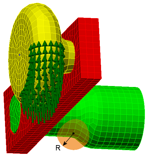

Often, critical stresses are limited to one or two small areas of a model. When Global Mesh Refinement is used, the resulting mesh is often finer than necessary because all elements are resized. A more efficient approach is to refine the mesh locally, only where the critical stress regions are. The Local Mesh Refinement command provides a semi-automatic means of performing this targeted mesh refinement on CAD-based models.
Before performing local mesh refinement, first perform the following steps:
Mesh Refinement
Local Mesh Refinement.
Figure 1: Local Mesh Refinement Region

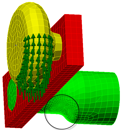

New design scenarios are created for each refinement iteration, and the original and refined design scenarios are solved. You will see the effects of the local mesh size reductions for each design scenario as they are being prepared. The following image shows the local mesh refinement for the last iteration of our example model:
Figure 2: Refined Mesh in Local Mesh Refinement Region

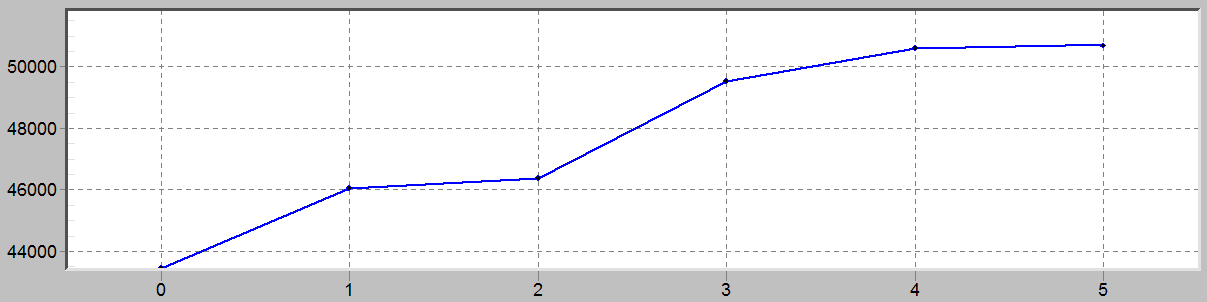

A graph of the Local Mesh Refinement Result is displayed in the Convergence Plot tab of the Output Bar.
Figure 3: Local Mesh Refinement Result (Convergence Plot)

The Local Mesh Refinement graph is based on smoothed results. Therefore, the graph agrees with the default stress contours viewed in the Results environment. The command Results Inquire
Inquire
Maximum Results Summary will generally show higher stress values, because this command lists unsmoothed stresses.
Ideally, the change in results will become insignificant in the latter iterations. When the element size is too coarse, stresses are not accurately captured. As the elements become finer, the stress results typically increase. Once the mesh is fine enough to produce accurate stress results, further decreasing of the mesh size produces a diminishing effect on the results.
Displacement results are usually less sensitive to mesh size and quality than the stress results are. Therefore, differences between displacement results may not be very significant even for relatively coarse meshes. Note the values along the vertical axis of the graph. The scale of the Y-axis can exaggerate the difference between the values.
Distorted elements can cause anomalous high-stress results. In such cases, the graph will look like the results are not converging. A single point of concentrated high stress (that is, a singularity), which is not explainable by the geometry or loads, can often be safely ignored. The stress results in the critical regions may be reasonably converged despite a graph that does not level off. It is the responsibility of the engineer or stress analyst to determine when it is safe to disregard results singularities.
