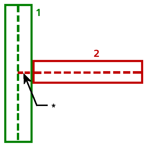

When two midplane-meshed parts intersect, the midplane surface of one part must be extended to intersect the midplane of the adjacent part. The figure below demonstrates the need for extended surfaces:
Figure 1: Extension of Midplane Surface Where Parts Intersect
The midplane of Part 2 must be extended to reach the midplane of Part 1. The extension length, indicated by an asterisk (*), is half the thickness of Part 1.
If you remeshed Part 2 with Part 1 suppressed, the midplane surface would not be extended beyond the boundary of Part 2. The meshes would not be conformal, nor would the parts even be in contact. The connection between them would be lost. Therefore, in such cases you also need to remesh the adjacent parts and, in turn, possibly the parts adjacent to those parts as well. You may have to remesh the whole assembly to maintain connectivity between all parts.
