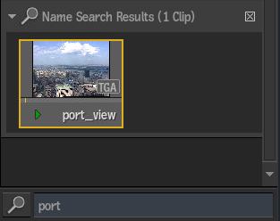

Searching in the Media Panel
To perform a simple name search, enter text in the field at the bottom of the Media panel and press Enter. A Name Search Results area appears near the bottom of the Media panel to display the search results.

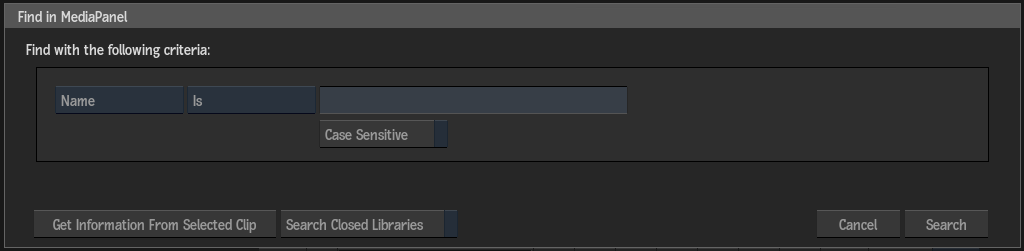

If you need a more advanced Media panel search, click the magnifying glass icon to open the Find in Media Panel window.
Here are some tips for advanced searches:
  • Many options are available in the first criteria box, such as Name, Resolution, Tape, and Comment. Other criteria is displayed to further refine your search, depending on the selection in this box.
  • Click Get Information From Selected Clip to fill the current search field with the information from the currently selected clip.
  • Click Search Closed Libraries to also search the contents of closed Libraries.
    • A Library remains closed if the Advanced Search cannot find any match.
    • A Library is opened if the Advanced Search finds a match.
