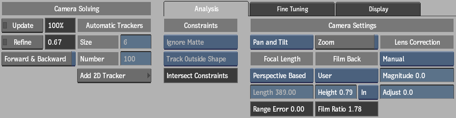

Perform Camera Tracking in the Analyzer menu.
Optional steps:
Camera Tracking

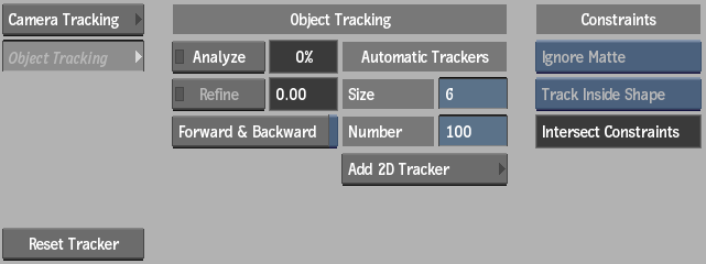

Perform Object Tracking. If needed, after camera tracking, you can track moving objects in the scene.
Object Tracking
