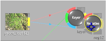

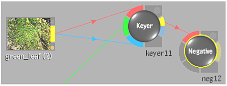

Action: Press and hold Shift while dragging the Negative node to the Keyer node
Result: The Keyer output is the front for the Negative node

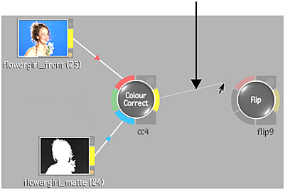

To connect nodes manually:
- Click the Result tab of a node whose result to be used and drag the cursor to one of the source tabs of the next node in the process tree.
An arrowed line is drawn from the node to the source tab. For example, click the Result tab of the Colour Correct node and drag the cursor to the front tab of the Flip node to flip the result of the colour-corrected clip.

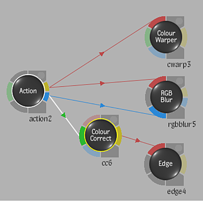

Tip: When working with a large ConnectFX flow graph, you can switch to a 2-Up view with the schematic displayed in both viewports, then drag and connect nodes from one viewport to the other.
