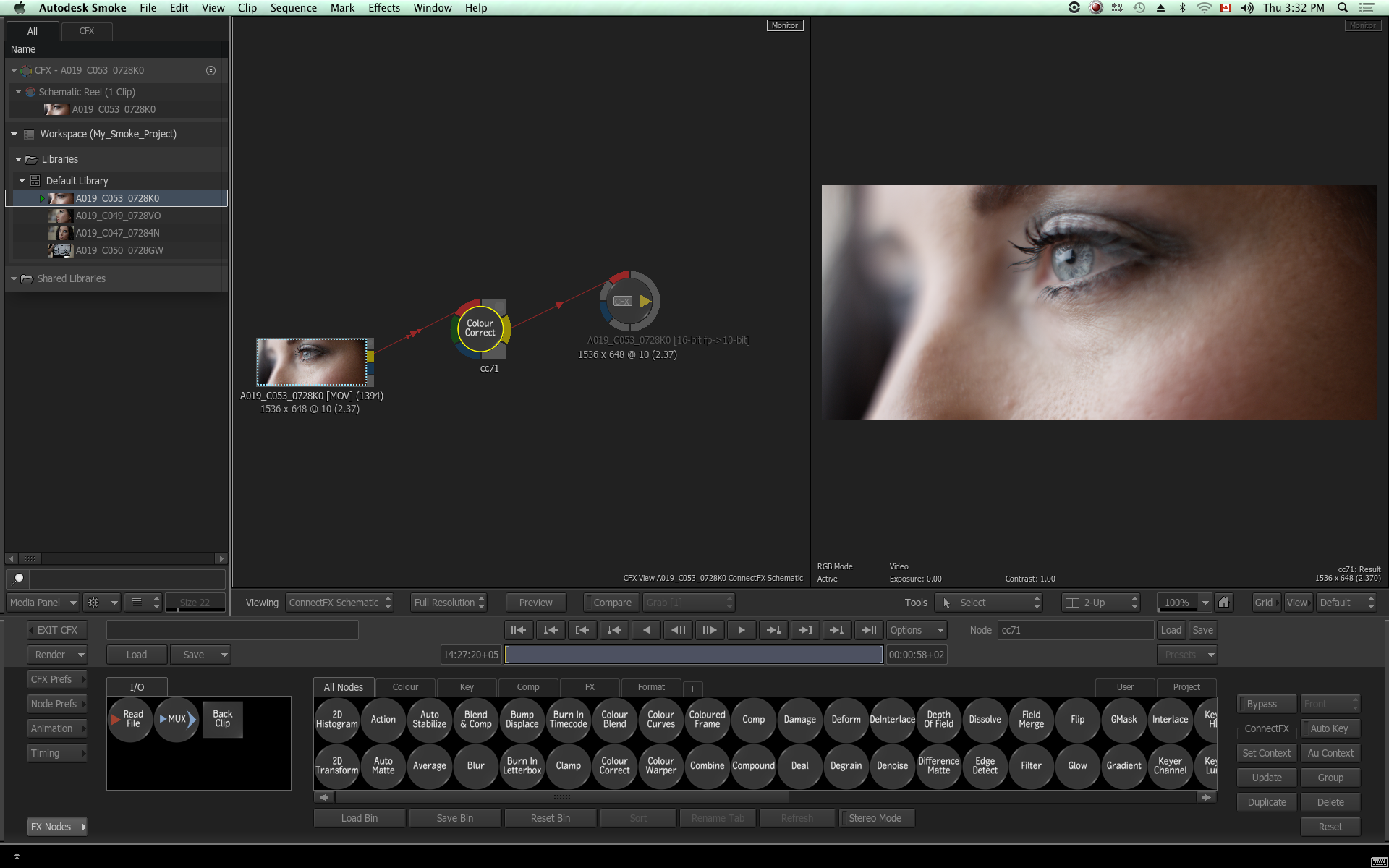

A typical ConnectFX view is shown below:
  • Use the Layout settings under the viewports to change the layout. The default view can be set in Timeline FX / CFX in the Preferences menu.
  • To change the actual view of the selected viewport, use the View Mode box in the viewing/layout toolbar under the viewports. If a selected node has its own views, such as Action, node-specific views may be selected as well.
  • The bottom portion of the ConnectFX view displays the nodes that can be added to the process tree. This bottom area can also display the menu for the selected node in the schematic view. To switch between the node view and selected menu view, use the FX Nodes button (located at the bottom left).
