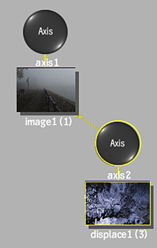

  1. In the schematic, select the surface or 3D geometry to which you want to apply the displacement.
  2. Click Media.
  3. In the Media menu, select the media you want to use for the displacement.
  4. Do one of the following:
    • Drag the Displace Map node from the node bin and place it in the schematic.
    • Drag the Displace Map node from the node bin and place it where you want it in Result view.
    • Double-click the Displace Map node. You do not need to be in Schematic view to add a node in this manner.
    The displace object is added to the schematic with its own parent axis. The new axis is the child of the selected surface or geometry. In Schematic view, the number in brackets next to the name of the displace node indicates the media used for the displacement.
    To specify different media as the displacement source, select the media in the Media menu, then click Apply.
