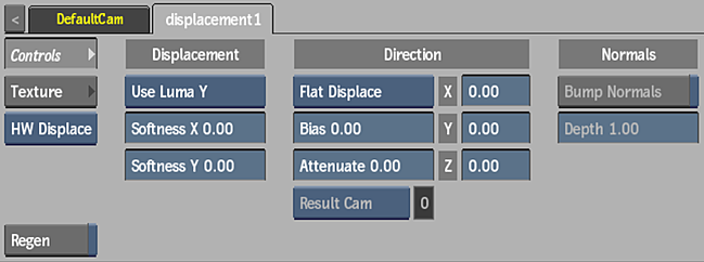

Hardware Displacement Menu Settings
Displacement Type box
Select whether to use hardware or software displacement mapping.
Regen button
Enable to dynamically refresh the image as changes are made to the menu settings.
The Hardware Displacement menu is divided into two tabbed sections: Controls and Texture.
Controls Tab
Channel box
Select a colour channel to calculate the displacement map.
Softness X field
Displays the amount of X-axis blur applied to the map. Editable.
Softness Y field
Displays the amount of Y-axis blur applied to the map. Editable.
Displace Direction box
Select the direction in which a displace occurs when a displacement map is attached to a surface. Geometries parented to a displacement map always use Normal Displace as the direction.
Select: To Displace:
Flat Displace In the X, Y, and Z directions.
Normal Displace Bilinear and bicubic surfaces according to their normals.
Camera Displace In the direction of the camera selected in the Displace Camera box.
Bias field
Displays the distance between the real surface of the object and the perceptual ground (zero level) of the texture. Editable.
Attenuate field
Displays the level of amplitude of the effect caused by the displacement map texture. Editable.
Displace Camera box
Active only when Camera Displace is selected in the Displace Direction box. Select which camera to take into account when using camera displacement.
Displace Camera field
Displays the active displace camera number. Non-editable.
Displacement X field
Displays the amount of displacement in pixel units along the X axis. Editable.
Displacement Y field
Displays the amount of displacement in pixel units along the Y axis. Editable.
Displacement Z field
Displays the amount of displacement in pixel units along the Z axis. Editable.
Bump Normals button
Enable to allow the map to create a normal map for enhanced lighting effects. Used only if no normal map exists for the object using the displacement texture. The availability of this setting is dependant on your graphics card.
Depth field
Displays the amount of Z scale applied to the generated normals. Higher values attenuate the effect toward the normals of the parent surface. Editable.
