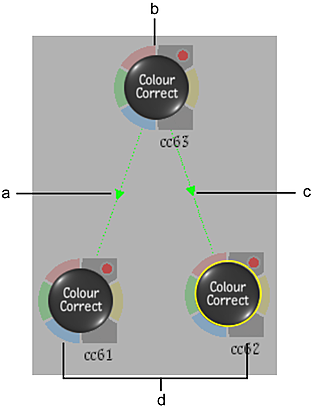

- In the schematic, drag between nodes of the same type.
A green-arrowed dotted line indicates that the nodes are linked as duplicates. The direction of the arrow indicates which node is the master.
(a) Duplicate link (b) Master node (b) Duplicate link (d) Duplicated nodes

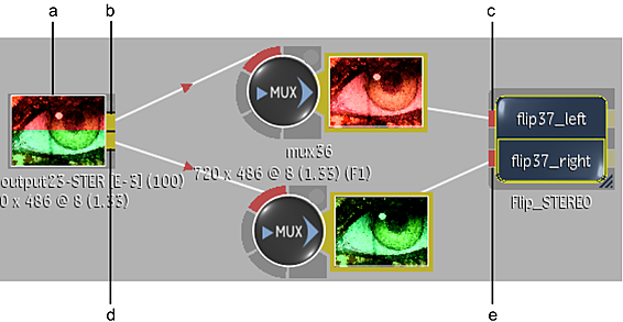

- With Stereo Mode selected, drag a node from the node bin to the schematic.
A stereo group node containing left eye and right eye inputs appears in the schematic.
(a) Left eye input (b) Right eye input
- Connect the left and right eye inputs of the stereo group node to the clip node’s left and right eye outputs, as shown in the following example.
(a) Clip containing stereo track (b) Left eye output tab (c) Left eye input tab (d) Right eye input tab (e) Right eye output tab

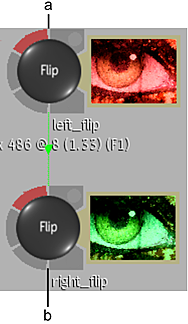

- Change the settings of either node.
Notice that the changes made to one node are mimicked on the other node so that both the left and right eye clips are affected simultaneously.
(a) Flip node connected to left eye is edited (b) Settings are automatically mimicked on Flip node connected to right eye
