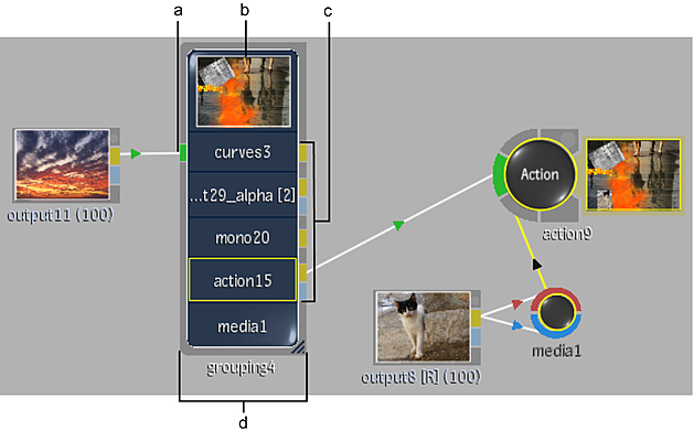

To group nodes:
  1. Command -drag to select the nodes you want to group.
    Selected nodes are outlined in white.
  2. Click Group, or right-click the selection, and select Group.
    The selected nodes collapse into a Group node. The Group node lists the nodes contained in the group, as well as the non-hidden input tabs and output tabs.
    Tip: You can also create a group inside a group.
    (a) Input connection (b) Proxy window (c) Output connections  (d) Group icon
  3. To rename the group, enter a name in the Node Name field.
  4. Click the group node to display group display and editing settings.
