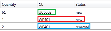

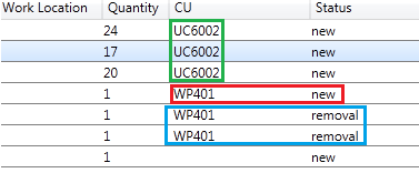

      For example, you might group material items by CU and Status in summation mode. All the material items with the same CU (UC6002) are grouped. Additionally CUs with the same Status are grouped.
      Materials in List Mode
      Materials in Summation Mode
    • Sort button sorts the groups alphabetically.
      In the Materials in Summation Mode example above, CU is selected as the Sort condition. The three CU groups are sorted alphabetically.
