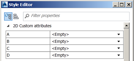

Define the style of work location blocks and then use style rules to apply styles to location blocks in your drawing. In the Style Editor you can define mappings between custom attributes on the block file and attributes in the industry model in your design drawing. You can also set a variety of 2D and 3D style attributes.
If you set attributes with prompts and defaults in the block definition, these prompts and defaults are used when you insert the work location in the drawing. You must set the custom attribute mapping in the Style Editor to Empty for the attributes. The prompt to set attributes is controlled by the ATTREQ system variable. If ATTREQ=0, you are not prompted to set attributes. If ATTREQ=1, you are prompted to set the attributes.
