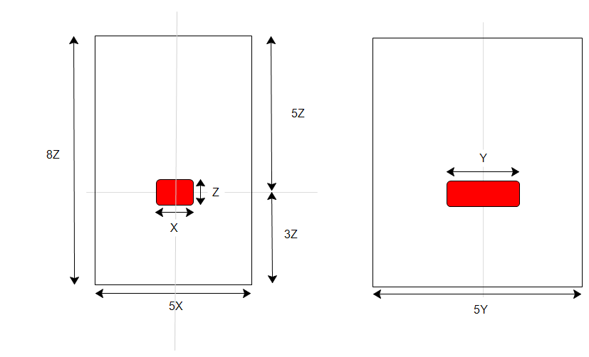

Modeling Considerations
Construct a box that surrounds the device. This is the calculation domain, and is where the air flows around the exterior of the device. The box should be wide enough so that the flow is not artificially accelerated. (If the side walls are too close to the heated object, the flow may accelerate as in a nozzle). The top of the box should be farther away than the base to allow for eddie currents downstream of the object as the hot air rises. An approximate guideline for the size of this box is a height 8 times the vertical dimension of the device, and a width and depth that are 5 times the respective width and depth of the device.
Construct this either in the CAD system or with the External Volume Geometry tool.
Boundary Conditions

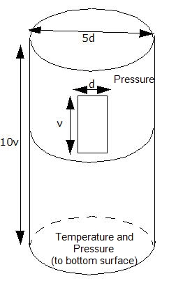

Construct a cylindrically shaped calculation domain that surrounds the device.
An approximate guideline for the cylinder height is 10 times the vertical dimension of the device. The diameter should be 5 times the width of the device.
The cylindrical surface should be divided vertically at approximately the same location of the device.
Boundary Conditions
Top: flat surface of cylinder, leave unspecified
Lower cylindrical surface:
Upper cylindrical surface
Bottom Surface of cylinder (flat surface)
