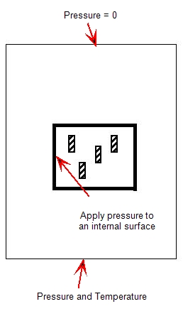

If the device contains flow, but is completely sealed off making it separate from the external flow region, then a pressure condition is required somewhere within the internal fluid region. This is illustrated below for the “Chimney” approach:
Assign the pressure condition to a wetted (internal) surface on a solid part (must be a solid material). This will ensure that the flow cannot pass through this surface, but will satisfy the requirement that the internal region is adequately defined numerically. The requirement of a pressure condition on every completely disjoint fluid region applies to all of the configurations shown above (“Chimney”, “Bucket” and “Hanging”). |
