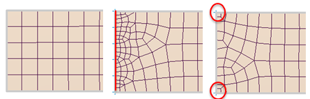

To refine the mesh locally, right-click on Mesh Model in the Model Tree, and select Add Mesh Control. You can apply mesh control for local mesh sizing on points, edges, and faces. You can control the mesh definition on edges either by specifying the number of elements or by the element size.
The mesh on the left has no local mesh control. The mesh in the middle has edge mesh control, and the mesh on the right has vertex mesh control:

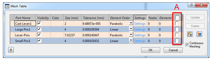

To control the element size, order, and specify advanced settings for the each part in the assembly, use the Mesh Table. To open the table, either click the Table button on the Mesh dialog or click Table from the Mesh panel in the ribbon.
With the check boxes (marked as "A"), you can mesh individual or selected parts. This is a very useful tool for locating meshing issues in assemblies.

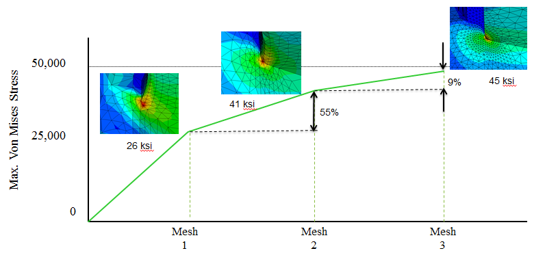

In general, a higher element count leads to greater solution accuracy. This is because more nodes are available for calculating the response and because smaller elements minimize errors due to discretization. The practical limit to the effect of the mesh on the solution accuracy occurs when a mesh-independent solution is attained. This means that the solution does not change, regardless of further reductions in element size.
You can control the mesh to lead to convergence by reducing the element size locally and globally and by monitoring the changes in results. Models will converge with fewer second order elements (Parabolic Tetrahrons, for example) than with linear elements. This is because a single second order element can capture a more complex strain field than a linear element. However, the cost associated with second order elements is that they typically take longer to solve due to the higher node count.
In the following, we see the effect of refining the mesh on the von Mises stress at a stress concentration point. As the mesh is refined from Mesh 1 to Mesh 3, we see a reduction in the amount of change in the stress at the point of interest. This means that the finer mesh is close to a mesh-independent solution, and smaller changes in the solution will occur as the mesh is further refined:

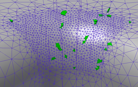

To determine if there are sub-optimal elements in the areas of interest (where stress is a significant concern), use the Check Mesh Quality tool. Open this by right-clicking on the Mesh Model branch of the Model Tree, and clicking Check Quality for all Meshes.
This tool performs an analysis of the mesh, and identifies areas that may need further refinement:
