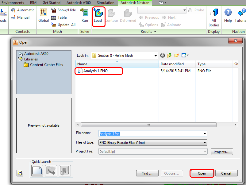

To load the results needed for this exercise, click Load from the Results panel, and select Analysis1.FNO:

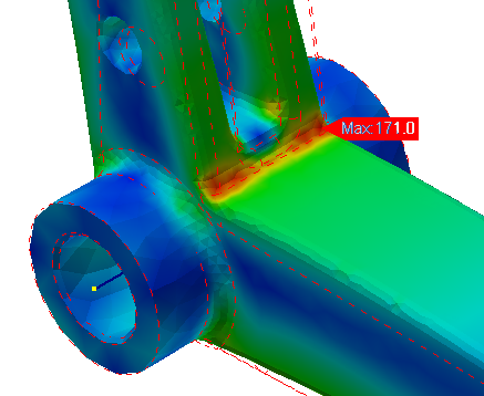

Upon close inspection, the stress results show a few indicators of potential convergence issues. The local face tangency is intermittent. In the following image, you can see that the results on the surface look "rough," and the area of high stress is "spotty."

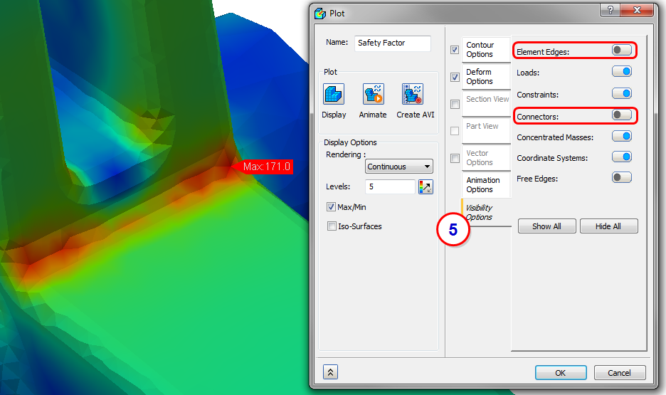

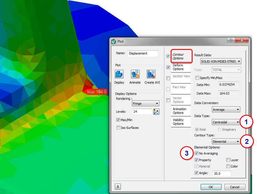

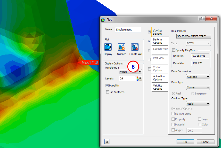

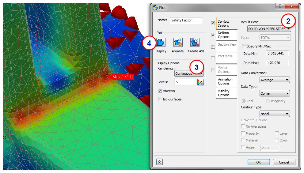

We'll start by displaying von Mises stress on the model and adjusting the rendering options:
Note that the unaveraged centroidal plot shows large jumps in stress across adjacent elements. This is a clear indicator that mesh refinement is needed.

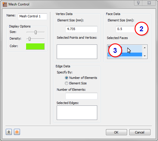

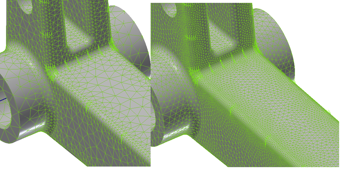

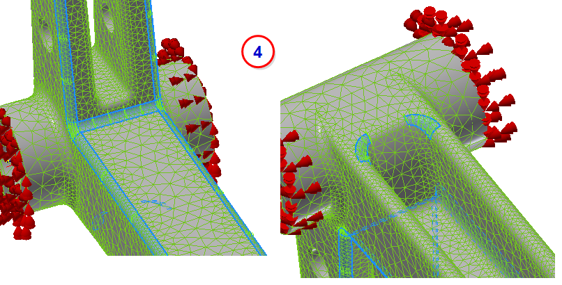

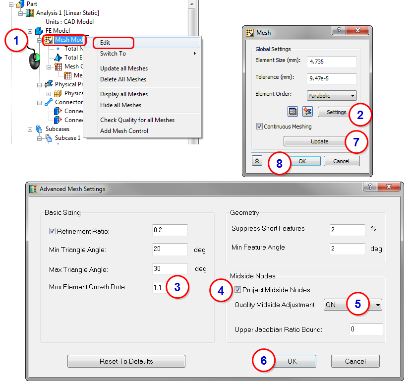

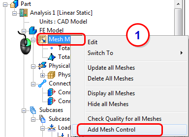

The original mesh is shown on the left, and the new one is on the right:
Click Run from the ribbon.

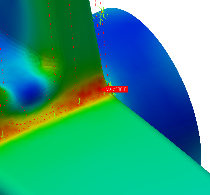

Note that the stress increased nearly 20% in this fillet:
