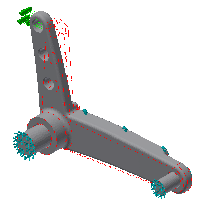

The primary use of the deformation plot is to show how the part or assembly changes shape in response to applied loading. To show deformation, right-click on Deformed from the results branch in the tree, and click Display.
To control the deformation plot, click Options from the ribbon, and click the Deform Options tab. Be sure the Vector is set to Displacement and the Type to Total:
To animate the displacement, right-click on the result quantity in the Model Tree, and select Animate. To modify the animation settings, right-click on the result quantity, and select Edit.

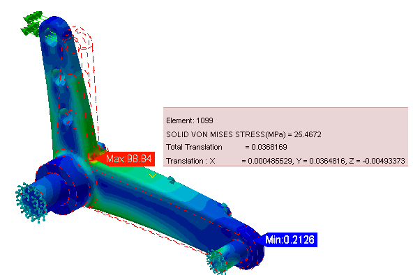

To view the exact value of a quantity on the model, click Probe from the Results panel of the ribbon. While the Probe tool is active, an information box displays the active scalar value where the mouse contacts the model:
